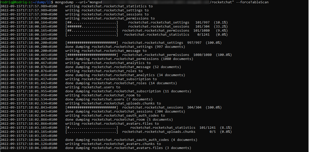

You should see something like the image below when the command is running
mongodump command executing

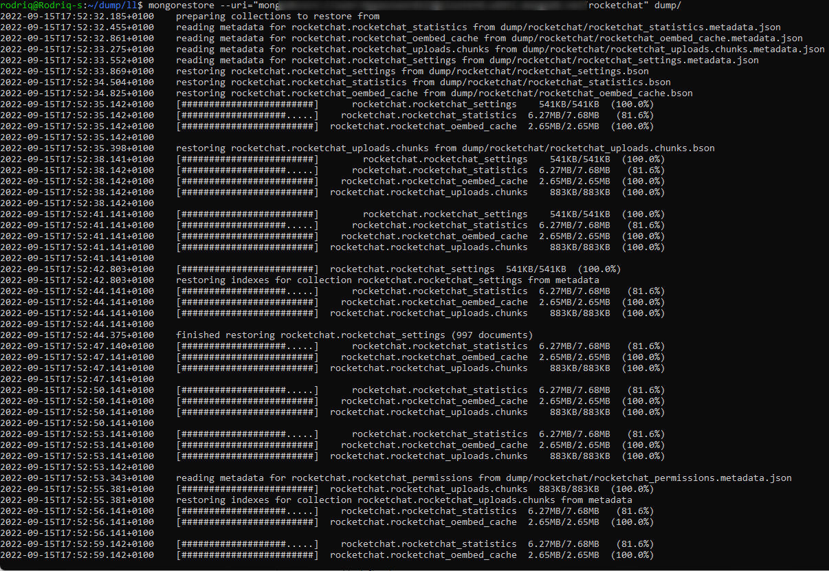

directory. See MongoDB docs In a successful command execution, you should see a screen like the one below
mongorestore command executed
