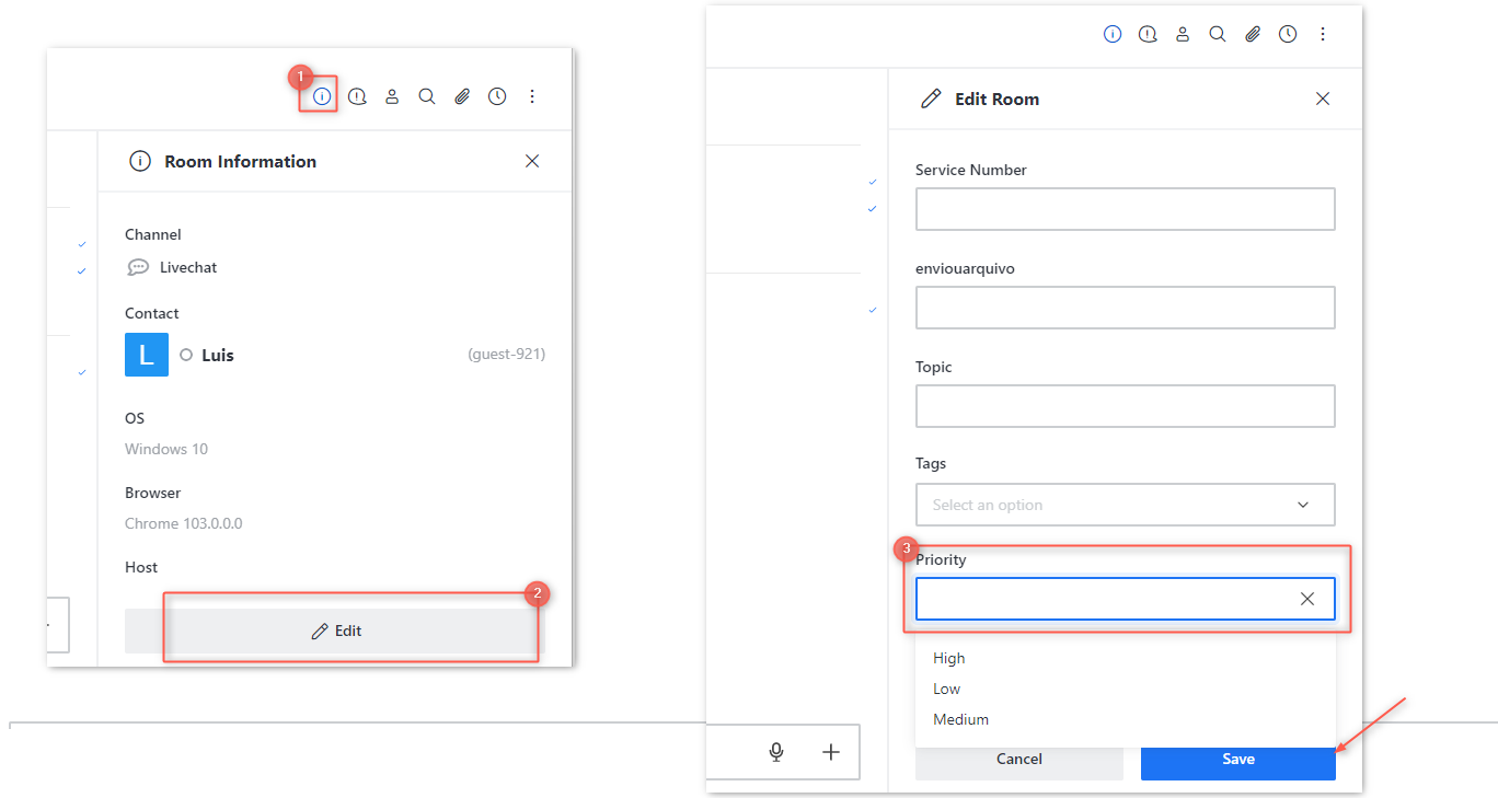

Priorities can be added to a conversation by editing the Omnichannel room info.
Omnichannel add priority to conversation
